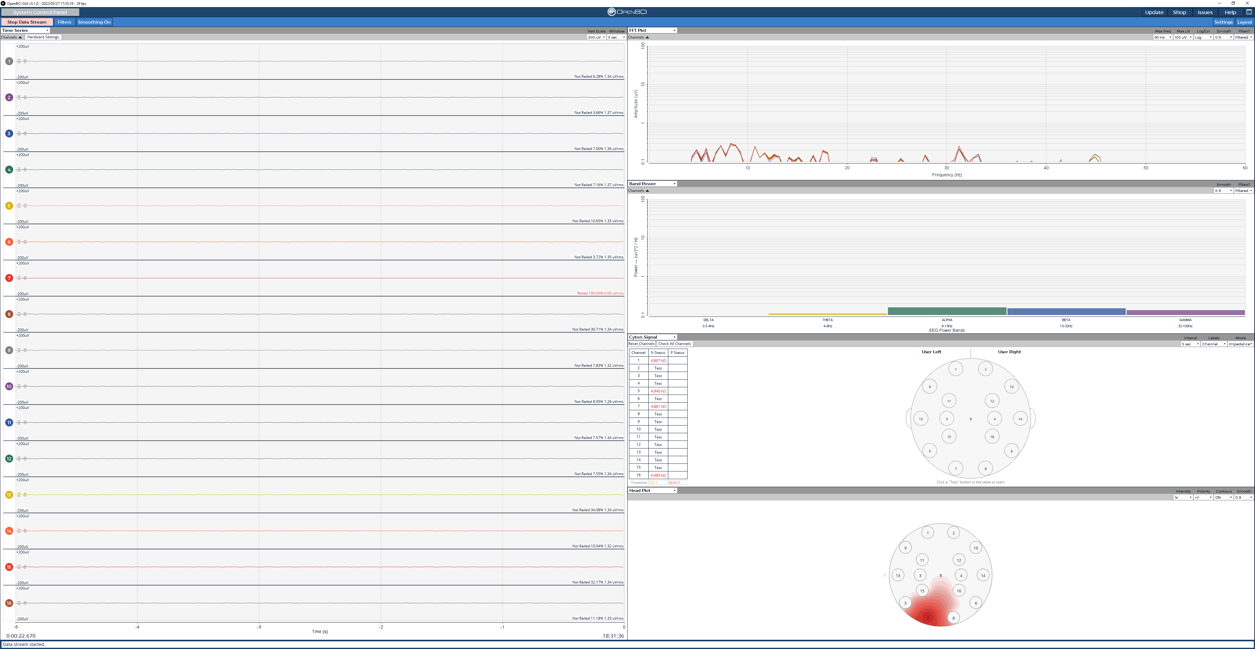

CYTON pin 7 (O1) is railed when no wires are attached to Cyton
Cyton board has no wires attached, and is powered by a fully charged battery, and is placed away from sources of electrical noise. Pin 7 (O1) behaves differently than the rest of the pins. The GUI shows that it is railed most of the time, and on the occasion that it un-rails, it displays a much higher % than the other Cyton pins. Hardware problem?
Cyton v3 - 32, OpenBCI Gui v5.1.0

William, thanks for replying. Not yet, I wanted to explore if it is a normal issue with the software, or possibly a known feature of the Cyton board, before I consider it to be a product defect. Do you think it is a defect?
Usually when no electrodes are connected, there is a slight bit of noise on the channel. And you can see that in your image, about ~ 1.3 uV, on all channels except 7. So yes, it does look suspicious.
