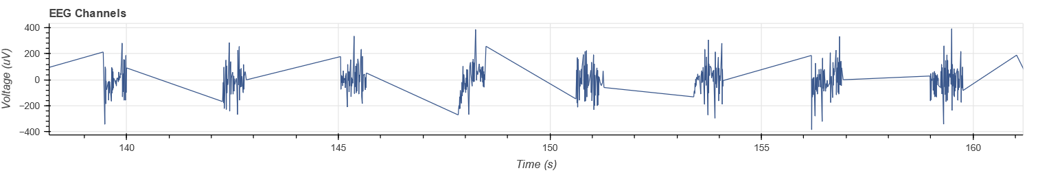

I have begun to have trouble with my Cyton+Daisy board that just started today. When streaming, the data does not stream continuously - there are consistent blank spots in the data roughly 2 seconds long. I also noticed that the red LED on the dongle flickers, and turns on/off to match these blank spots.
