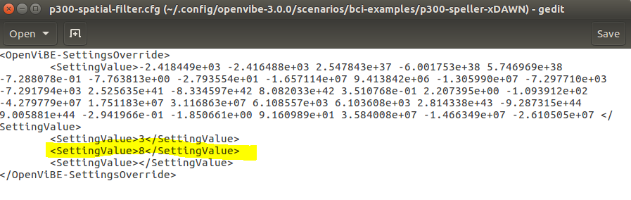

I am also considering running the xDAWN classifier over the basic p300 speller classifier. My current headset is only 8 channels--so I have changed the spatial filter config file so that the second setting value is 8:
Will the classifier still perform as well with 16 channels as it does with 8?

Best place to ask OpenViBE questions is their own forum. However if you look on there, I believe the speller is still not being supported.
