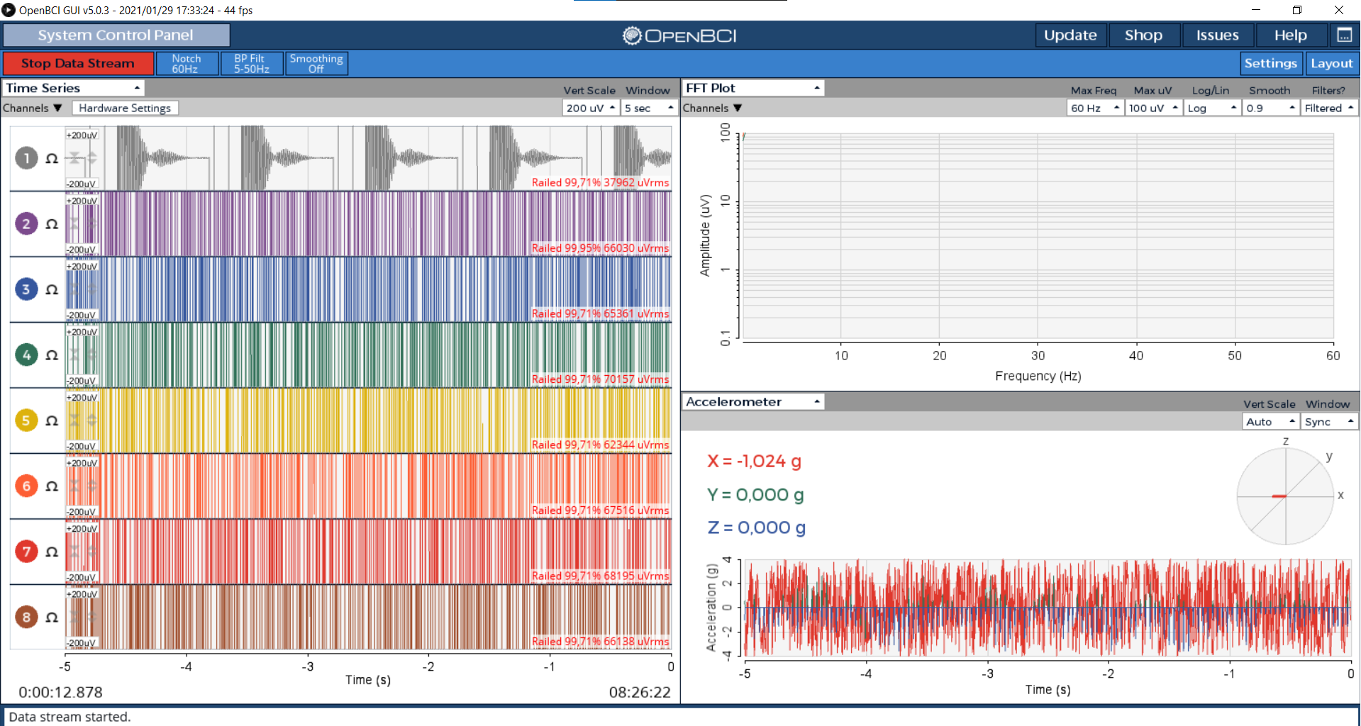

Hello everybody! I've been reading about updating the firmware on the cyton (acquired after fall 2016). Something went wrong, as the Cyton Board is not working properly. I have been reading some forum discussions and they have guided me but I have not been able to solve it.

The lights blinked as the tutorial indicates but the result is strange. The accelerometer is crazy and on channel 1 I always see a noise. Any advice on how to fix it? what am I doing wrong?
I am attaching a screenshot of the GUI with nothing connected to the Cyton board.
