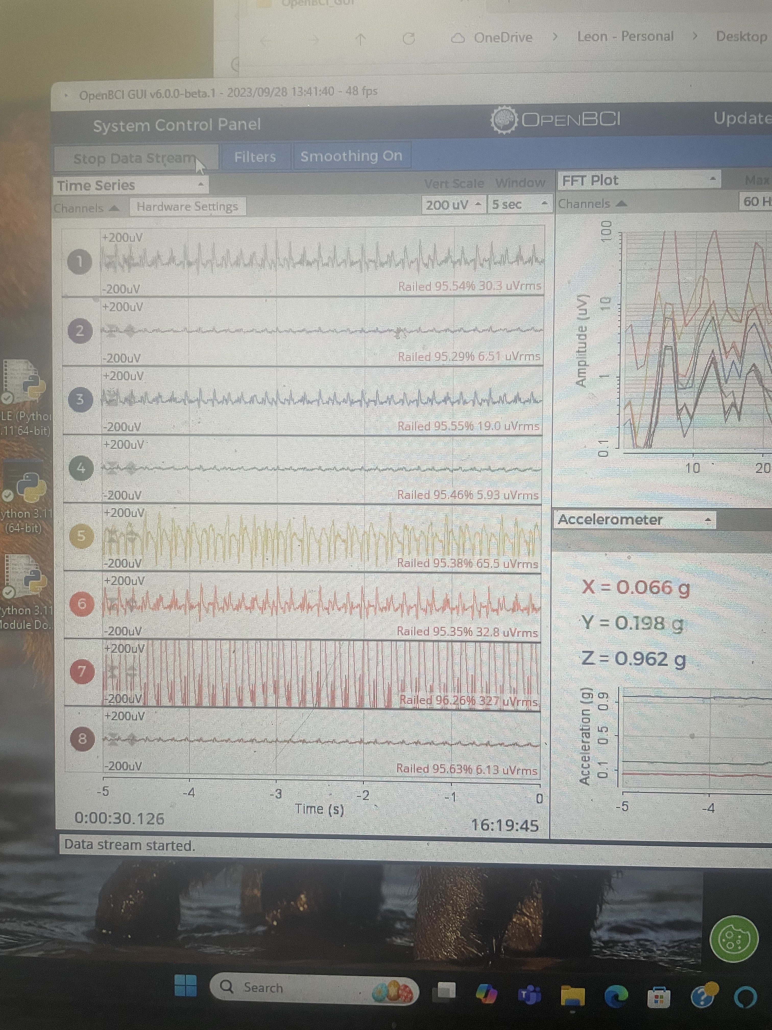

i am having what looks like synthetic algorithms on my Cyton when not hooked up I thought it would be my cyton It could be something else though
The Time Series and FFT graphs you show, are evidence of 'environmental noise' in your area. Such as from LED lighting, power supplies, wireless gear / cell towers, AC power line sources such as extension cords, conduits, etc. Have you tried moving your setup to another location to see if the noise shifts away? There are also EMF Electromagnetic Field monitors available as phone apps or inexpensive devices on Amazon.
Notice how the noise spikes perfectly align across the channels. This is a sure sign that the noise is coming in identically on all channels. What were your electrodes connected to in this case? If you look more closely at the entire FFT graph, you may see a primary frequency then harmonics or sub harmonics.
The noise source primary frequency seems to be about 7 Hz, as seen from the time series and FFT. Then harmonics of that primary at higher frequencies (lower amplitude than primary.)
