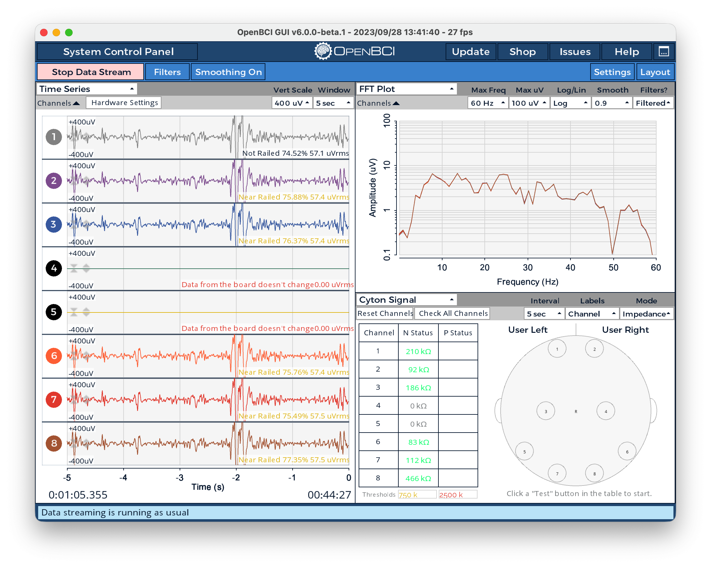

When I look at the OpenBCI GUI, the time-series signals and the FFT plots seem almost identical across the active channels.
This makes me unsure whether I am recording real EEG activity from each electrode position, or whether there is a problem in the hardware, reference/ground connection, ear clip, or Cyton board itself.

    This looks like a reference / ear-clip problem, not the individual electrodes or the Cyton board.
    The giveaway is in your screenshots: all active channels sit at ~57 uVrms and go "Near Railed" together, while the impedance check shows finite values (83–466 kOhm) — so the inputs aren't floating. That means every channel is dominated by the same common signal (mains hum + reference noise), which is exactly what a bad common reference does. On the Ultracortex all channels are Electrode_n − SRB2, and SRB2 comes from the ear clip. If that contact is poor, the shared term shows up identically on every channel.

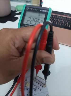

    Hi, I measured the SRB pin and BIAS pin using DMM, is it correct that it has a value of around 4 MOhm, sometimes 20MOhm?

    That reading doesn't really tell you what you want, and 4–20 MOhm between SRB and BIAS is expected — don't worry about it. SRB and BIAS are separate nets and aren't supposed to be connected to each other, so probing across them on an unpowered board just measures high-impedance nodes through the on-board circuitry, which reads high and drifts. It doesn't confirm the reference is working.
    What you actually want to check is continuity of each cable to its pin: put one probe on the metal contact of the ear clip and the other on the SRB pin — that should read close to 0 Ohm. That confirms the clip is wired through to the board. (Same idea for BIAS to its electrode, if you want.)
    But the DMM can't measure the part that usually causes this — the skin–electrode contact at the earlobe. For that, use the GUI's built-in impedance check (it drives a known current) and the square-wave test. Those two will actually tell you whether the reference path is good in operation.

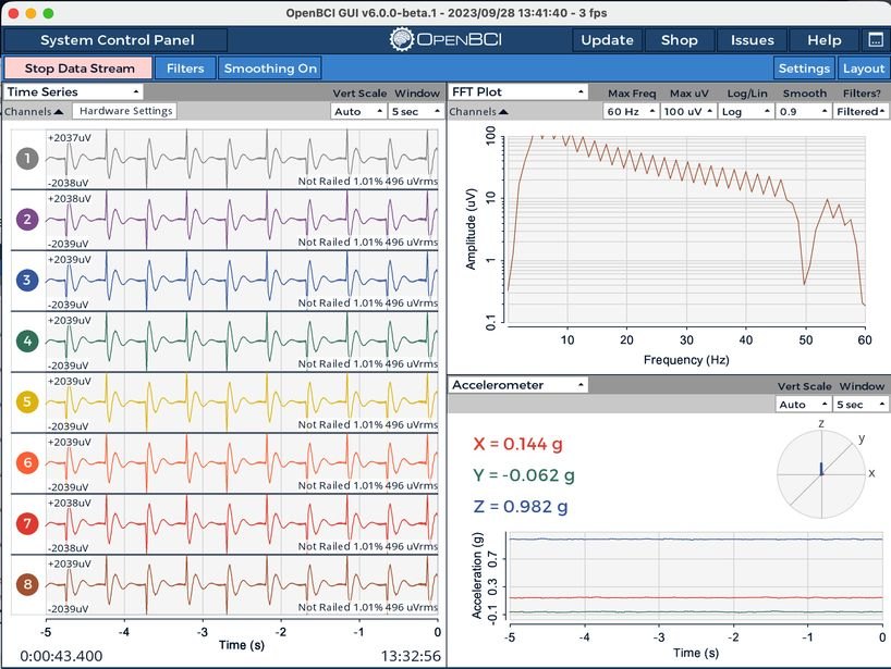

    A strange thing happened: instead of getting a square wave, I got an ECG-like waveform.
    I followed the tutorial on https://docs.openbci.com/Cyton/CytonSDK/
    When I send -, =, [, or ], I get an ECG waveform with different frequencies and amplitudes.

    Did you turn off all filters?
    The test signal really is a square wave, but the GUI applies a band-pass and notch filter by default, which reshapes it: the flat tops droop and the edges round off, so it ends up looking ECG-ish. To see it properly, do what the SDK docs say: turn all filters off and set the vertical scale to “Auto”. The scale matters too — the test signal is almost 2 mV, so with a fixed scale it gets clipped and distorted, which adds to the ECG look.

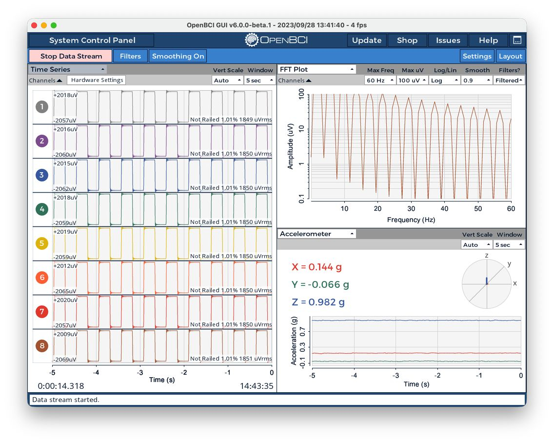

    Wow, great advice! works like a charm. Thank you
  • So, I think there is nothing wrong with the board.

    That looks great! The board is fine.
