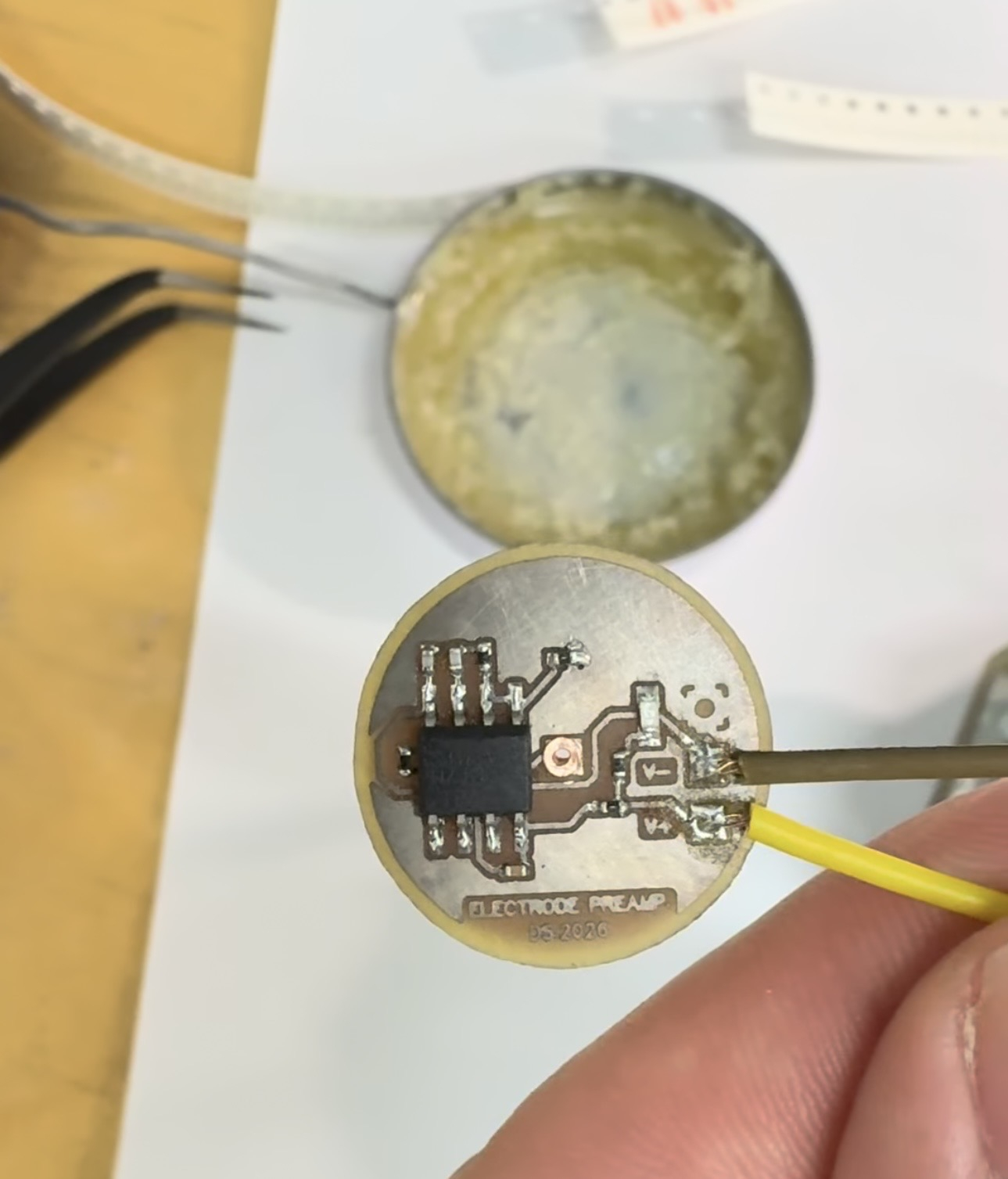

Sure no problem! Here you can have a look on how I did it. I connected the electrodes with the preamp using via wires (typical solution in diy pcb). The single silver wires are soldered on the tiny round fr-4 plate. Of course you can use pin headers or snap header (difficult to get tho) to connect the two. I’m using this method for the new design I’m currently working on (2nd image)

I use avdd and avss directly from the board to power the tlc272. My design is based on the schematics from the link I posted and it works pretty well so far. I guess if you use only 8 electrodes it’s fine (usage ~4mA)
I don’t think the DC servo loop is necessary, since it is (as far as I know) already in the ads1299. Pls check the data sheet because I’m not 100% sure.

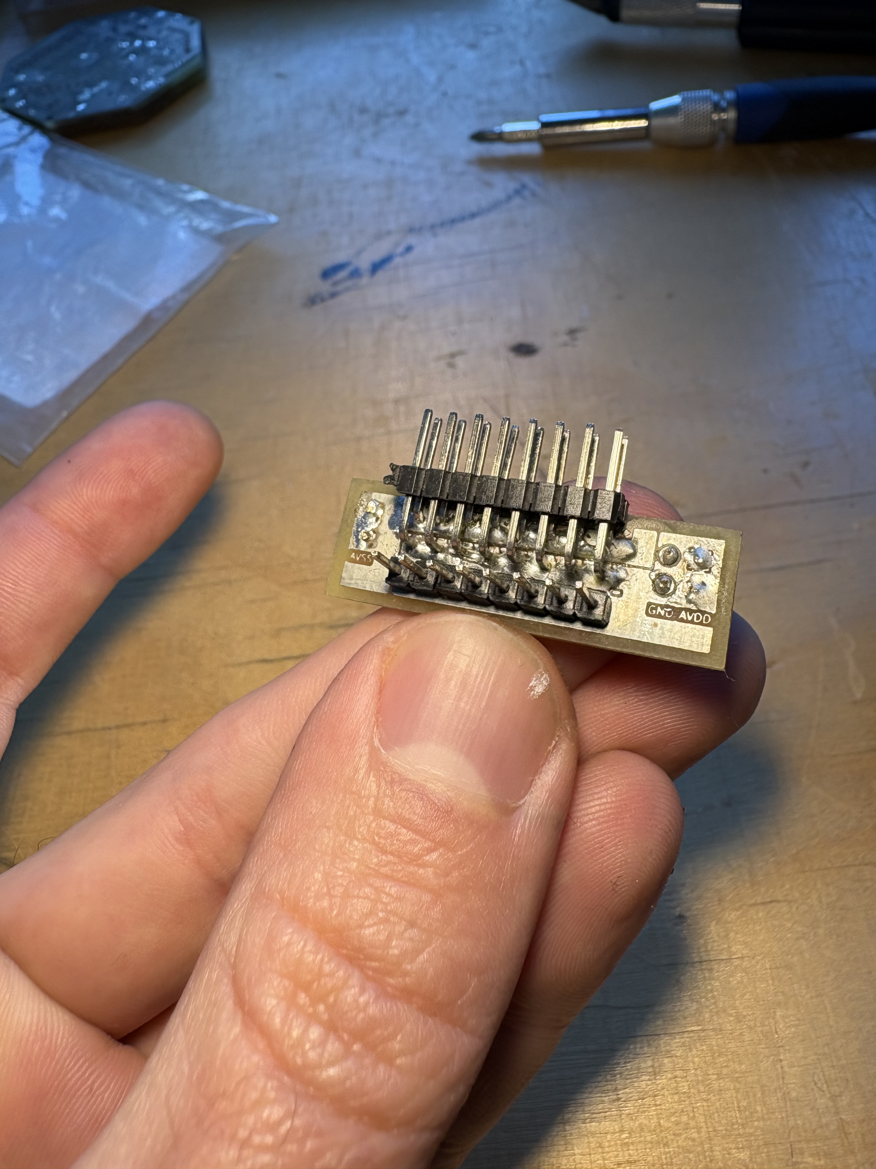

You then need to build an adapter in order to use the AE (Thinkpulse use it too). Here is the one I’ve built. It has pin headers for avdd, avss and gnd (for the cable shielding). The signal cable is then connected in the board.
Hope I understood your questions.
