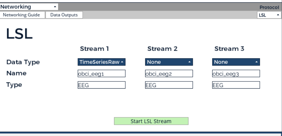

i'm working on a bci projcet using the ultracortex markv headset while reading the values coming from cyton and the daisy board i got huge numbers ;( i'm using gui lsl to stream the data with osychopy and lab recorder ); should i rescale this data before preprocessing it and feeding it to the ai model ?

As i'm streaming the data via lsl in the gui ; should i rescale the data sent from the cyton or a dc filter is enough ? as it is raw adc numbers not microvolots ?
Data stream is always in microvolts.

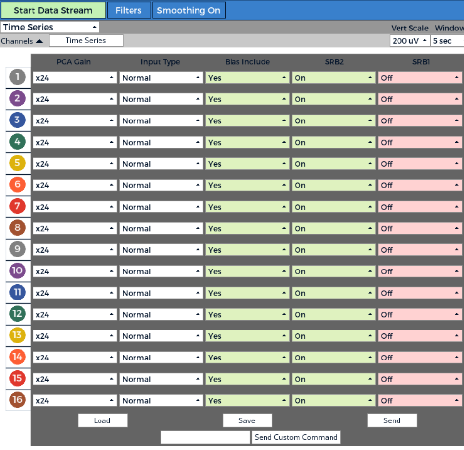

is it normal to have those values while sending from the gui via lsl getting an xdf file(i ve got those values knowing that on the gui a gain*24 is applied and srb2 is on
