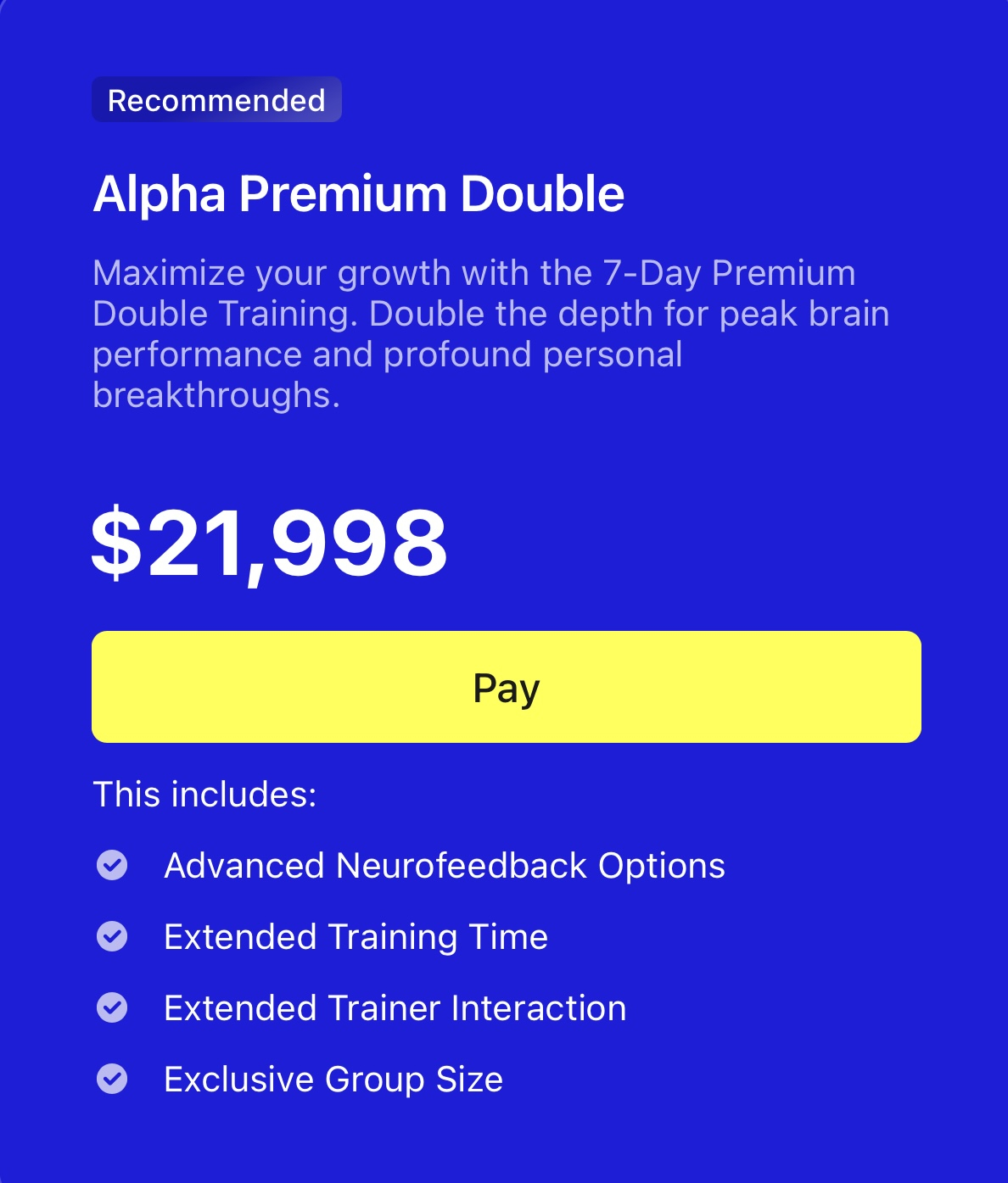

    Agreed, Hardt’s training is out of this world expensive- at a whooping 22k a week. But the results, even though not as exaggerated as advertised, are legit. I attached his book. He explains some of the process there.
    I’m really hoping I can set my own EEG neurofeedback at home. But is that just not realistic?
