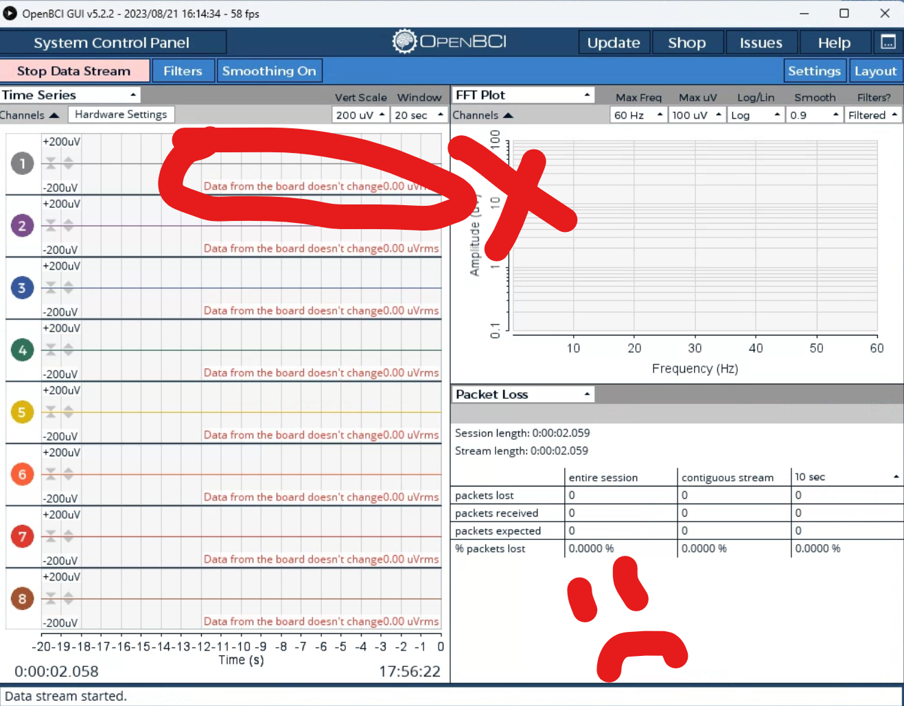

I have a weird problem that just started happening with one of my Cytons:
1) Cyton powers on (Blue LED)
2) I connect to the Cyton using the OpenBCI GUI using "manual connect".
3) It allows me to push recording settings to the Cyton (says, "Hardware Settings Sent to Board")
4) When I hit 'start logging' it says on every channel, "Data from the board doesn't change", and no data is shown.
I've replaced the Cyton battery, restarted the computer several times, but doesn't help.

    Your third image shows ZERO packets received. So data stream is indeed not flowing.
