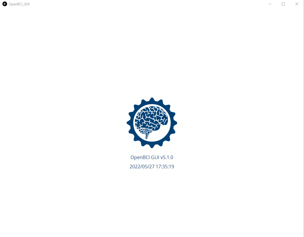

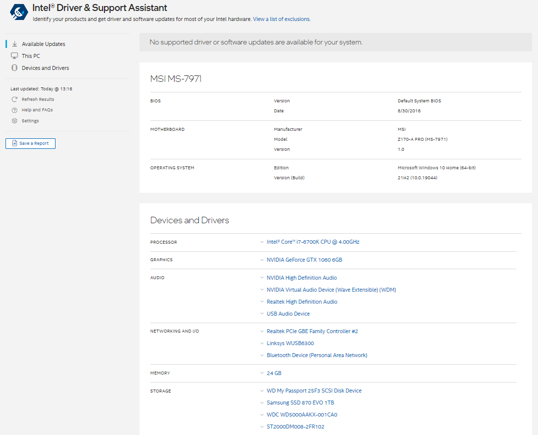

I am also having this problem. A few months ago I followed the steps suggested in this thread and others and resolved it. The past few days I have been using the GUI I had no issues. As of this morning however, the issue has come back and I had not changed anything since last night when I last ran the GUI with no issues. I have attached a screenshot of one of the console logs, all of which are identical today. I updated my drivers through Nvidia (I have a GeForce 1060) and also my Intel drivers (I have attached images of my system specs). My operating system is Windows 10 64-bit. I have also confirmed I have OpenGL version 4.6 (see attached image). I have tried both the Nvidia Game Ready Driver and Studio Driver. I have tried restarting my computer multiple times as well.
Apologies if there is a simple fix for this, but I could not find one on the forums or github that works for me, but I need a solution urgently.

It seems likely that some background Windows update process installed new drivers or OS modules. Is it possible you can use OpenBCI on another computer? Other online material suggests that your MSI computer may have been manufactured in 2016. Seven years ago, which implies it may have lost support from MSI or NVidia.
But more addressing the log file errors you are showing, they seem to indicate an issue with your sound card setup. NOT the graphics card / drivers. Try reconfiguring your Windows sound control panels.
