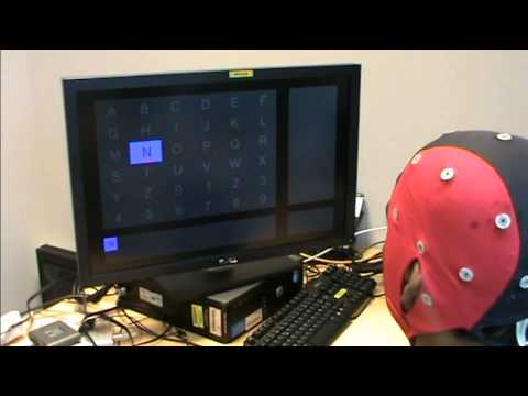

    Certainly you'll want some sort of headset or EEG cap. It's looking like the g.tec g.GAMMAcap2 is a pretty good interim solution until next generation headsets (using dry active sensors) surface. The g.tec cap can likely be used with a number of electrode configurations: (1) Jeremy's 3D printed holders for injected gel applications. (2) no-gel/no-paste saline solution pads with Ag-AgCl buttons. (3) the dry Ag-AgCl combs that Karl @kzurn is trial-ing (see electrode thread). These 'dry' combs can also be injected with gel if needed through the hole on the top.
    And there are also the classic Electro-caps, 19 channels, injected gel. Cost of the Electro-cap and g.tec cap is comparable. (Around $230). Both elastic caps fit a range of head sizes. But they offer a large size as well for those of us swell-headed guys.  :-)
    Who knows how many electrodes are going to be needed for your application? If you look over that list of prior research in Yurci's thesis, there is a wide range of percentage accuracy figures for emotion classification. Yurci himself is using all 14 channels of the Emotiv EPOC, and achieves superior accuracy compared with the earlier algorithms. I'm not sure his system though was live & realtime, vs. post processing.
