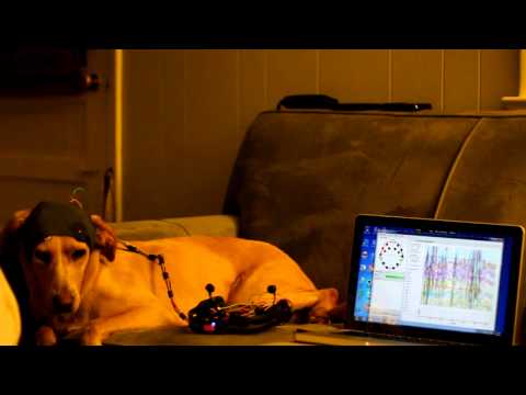

I am curious which headset and which software have been used in this video?
I was not suggesting "researching on humans", I was instead suggesting that you do some EEG experiments with yourself. This will be much easier than working with animals.
If you look at the comments of the video and the wiring, this is one of the Emotiv EPOC saline based headsets. He has run extra wires from the headset, over the dog's head. EPOC uses saline soaked pads, and he has done the same with the dog. I would not call the setup on the dog's head, a "headset" per se. It looks to me like an elastic band that is holding the saline electrodes in place. It looks like he has used plain cup electrodes for the electrodes, perhaps with a saline soaked sponge under each cup. I doubt if the elastic band is placed on the head in one smooth operation. (Like an actual headset.) He likely placed the elastic band first, then fished each individual electrode into approximate position. Awkward and time consuming, and probably inaccurate as far as repeatable positioning.
If you look over on the screen, you can see huge amounts of noise in the signals. (High amplitude, very fast oscillations.) It looks like mains noise to me, 60 Hz. On most channels. This complete obliterates any valid EEG signal in his case. Such high mains noise is usually the result of poor grounding, reference, or AC magnetic fields.
Other types of noise visible are from movements of the dog's body / head, which cause EMG spikes (muscle artifact). Here is another insightful statement from the author in his comments:
