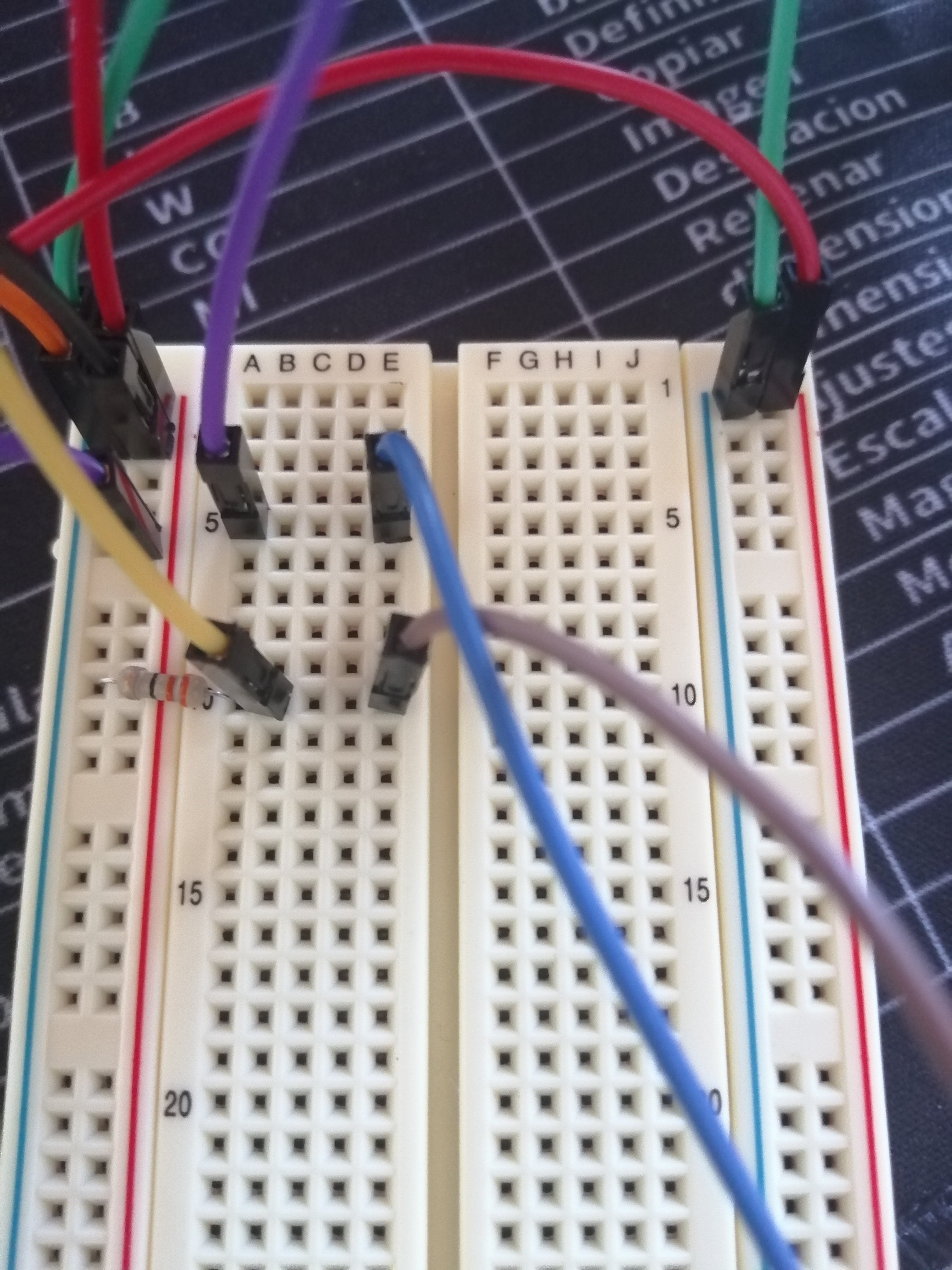

I've tested the solutions presented in the examples, but still missing something. I can not see changes in the sensing signal coming from the photodiode, maybe expected if there is not a graphical channel for this during the data stream. But in the output I can't find it either, only changes I notice are in Analog Channels 0,1, but the values are constant.
Eg.
Analog Channel, Analog Channel 1
257, 256
257, 256
257,256
I've tryed disconnecting the power to the photodiode (once it is a photodiode not a photoresistor), but can't see no changes. I've also tryed by using the "digital read" function, and pressing the PROG button on the Cyton, but no success either.!
Am I missing something in the software?
Thank you.
Gilberto, hi.
Do you have a digital voltmeter? Measure what you are sending to the analog input pin in both light and dark conditions. What do you see? The analog pins can measure between 0V and 3.3V only. That voltage range is mapped to a 10 bit value from 0 to 1024.
As a side note, the photos you are posting are around 7 megabytes each. Please read:
https://openbci.com/forum/index.php?p=/discussion/comment/11483/#Comment_11483
Thank you wjcroft,
I've changed the photodiode for a photoresistor, as indicated https://github.com/OpenBCI/OpenBCI_Experiment.
But I can see no changes in the stream, neither in the output values.
Voltmeter indicates 1.4 in light mode, and 1.2 in dark mode.
What is the output channel for D13?
I am very sorry for the pictures, seems like I can no longer edit the comment to erase them.
Did you use the Widget in the GUI to select Analog Board Mode? There are separate controls for Analog and Digital modes.
https://docs.openbci.com/docs/02Cyton/CytonExternal#using-the-openbci-gui
You mention:
That is not much of a difference. Should be larger. Are you sure you have the correct photo part? Even so, the analog mode would show a difference with these two values.
1.4 / 3.3 * 1024 = 434
1.2 / 3.3 * 1024 = 372
Thank you William,
R: Yes, I've done this according to tutorial. I was expecting to see some color or value changes in the circles of the widget, but no changes.
R: Agree, but I tryed with the photodiode and the photoresistor, having no changes as well.
Thank you for the values conversion,
In what channel of the output should I look to find these values anyway?
Could it be something wrong with the channel?
Thank you again.
If you are NOT seeing the analog values showing up in the widget, then likely your wiring is wrong. Yes you want the analog version of the widget. Why? Because digital mode logic expects only TWO values: zero volts for logical zero. And 3.3V for logical one. Your diode output does not produce digital values.
Check your recording in the Aux fields. That is where the analog board mode values are stored.
RESOLVED.
The input for the Cyton was not D13, as indicated in: https://openbci.com/community/measuring-stimulus-timing-with-a-photoresistor/
but D12 as indicated in picture in: https://github.com/OpenBCI/OpenBCI_Experiment
Thank you!
