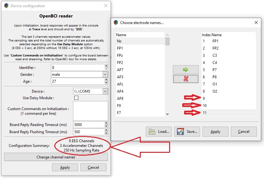

I m trying to use OpenVibe and asking for 3 accelerometer channels (see img below)
What should I put as accelerometer channels?
Thanks,
M.

  • Dear @retiutut,
    Thanks for your response.
    What I have to put on index 9, 10, 11 in the right column from the list in the left column in OpenVibe software?
    Note there are all of the different channels on the left name list.
    You can choose ANY names you wish. If X, Y, Z are not available, then choose ANY other names which you desire.
