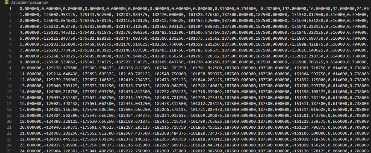

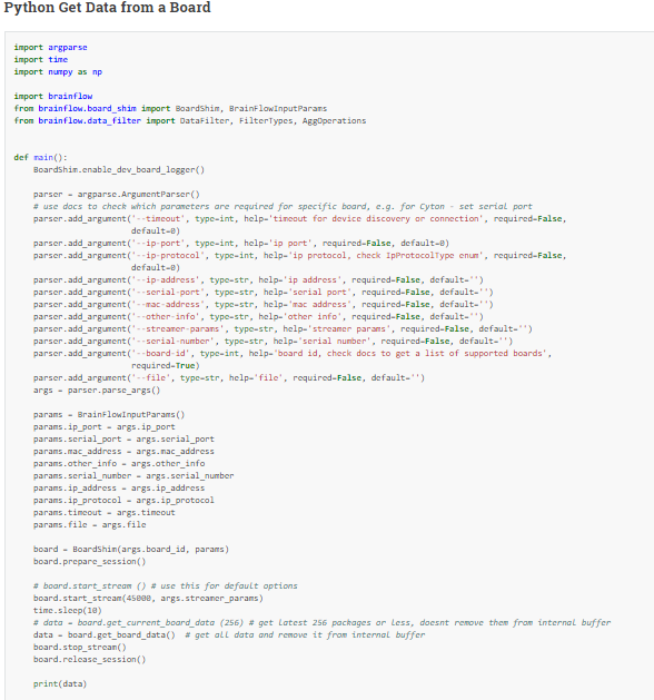

I have a question with the data i capture with this code.
I don't know if the part of EEG's data are in microvolts or other units. can you help me with that?
if this code put the data in microvolts, where does it do that? @wjcroft @retiutut @andrey1994 @evaesteban
Units are microvolts. You need to pre-filter the data stream, to remove the DC offset.
