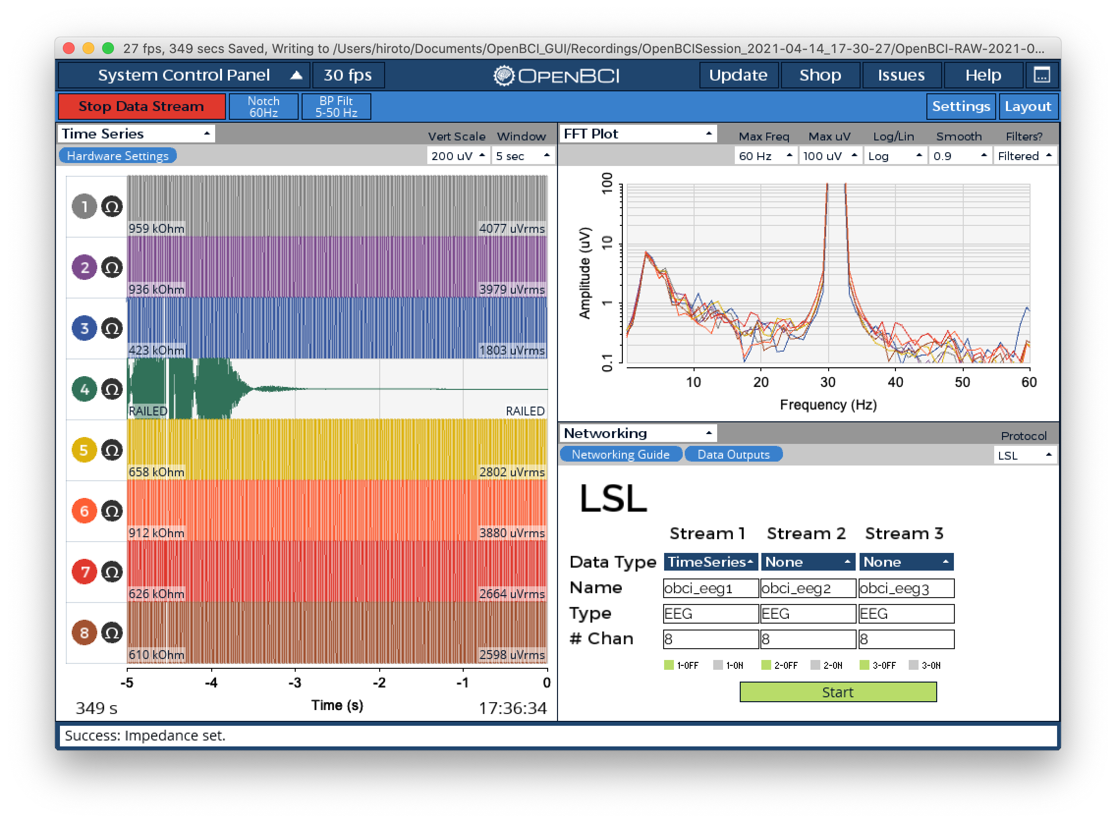

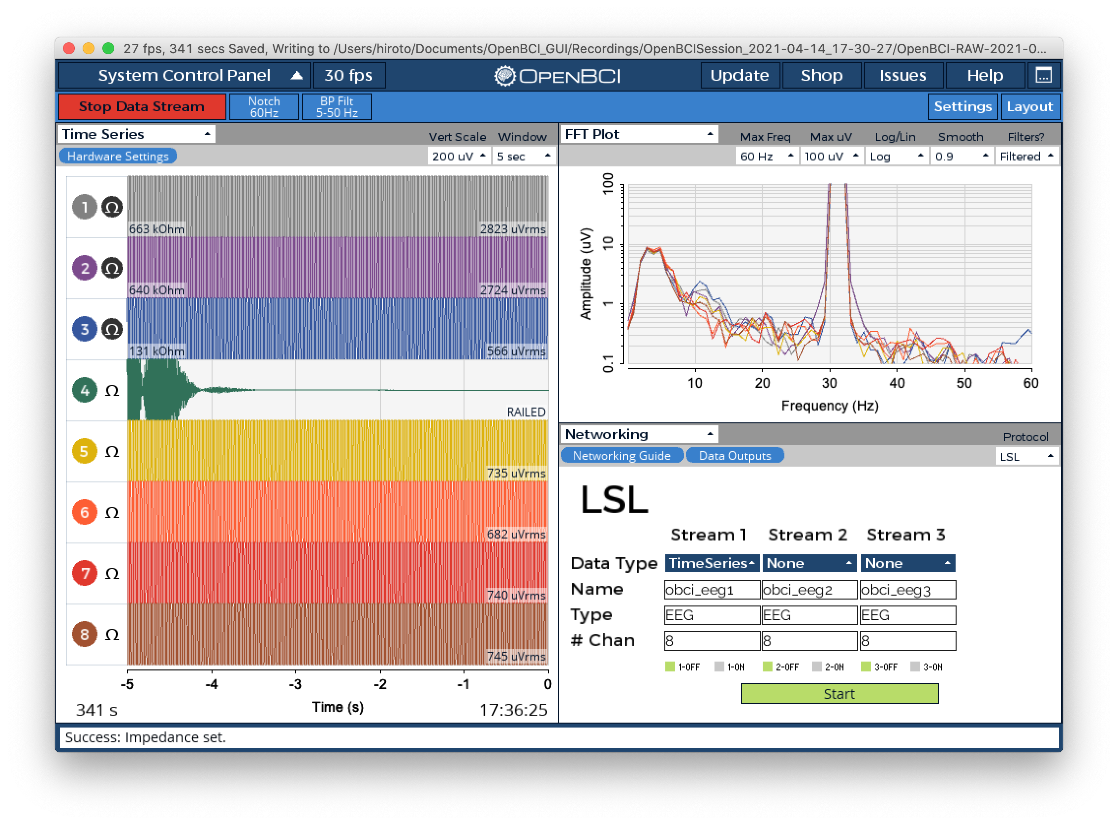

When the impedance of one electrode is measured by OpenBCI_GUI, the impedance is relatively low. However, when several electrodes are measured at the same time, the impedance becomes higher. Which impedance is correct?
I'm using OpenBCI_GUI v4.1.7. Sorry if this problem was solved.
