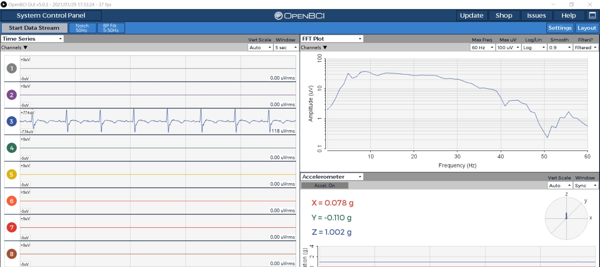

Hi, Thank you so much for previous response. I was to use the board excellently. The attached screenshot was the ECG I collected using dry capacitive bioelectrodes (in non-contact mode). The dielectric material I used was polymer about 0.14mm thick. Please may I know at what frequency does the board measure skin impedance? I mean the pre-set frequency. Also, where can I find addition details about the board?

    It's interesting you mention "the ECG I collected using dry capacitive bioelectrodes (in non-contact mode)." Do you have any further references? It sounds like these are your own construction. I do note a couple things about your ECG signal: the amplitude seems quite low 118 uV RMS. I guess this is explained by the non-contact coupling. And the signal also appears completely 'centered' as far as polarity. Also explained by the AC coupling from the non-contact.

    Thanks for the response. My goal is to test the polymer dielectric I fabricated and observe its performance in capacitive ECG recording. Though, I also collected ECG using the AgCl (Ambu White Sensors), Silver Coin, and Flexible PCB. I tested the last 2 under different skin conditions (dry skin and sweating). In capacitive biopotential technique, the dielectric material strongly influences the quality of ECG wave. Like I said earlier, I am only performing a test to prove that capacitive ECG sensing is possible with the polymer dielectric I fabricated. The amplitude of the ECG will be affected due to limitation of the Cyton board and dielectric polymer. ..Meanwhile, I fabricated the bioelectrodes in various sizes. ..the performance was not the same in all.
