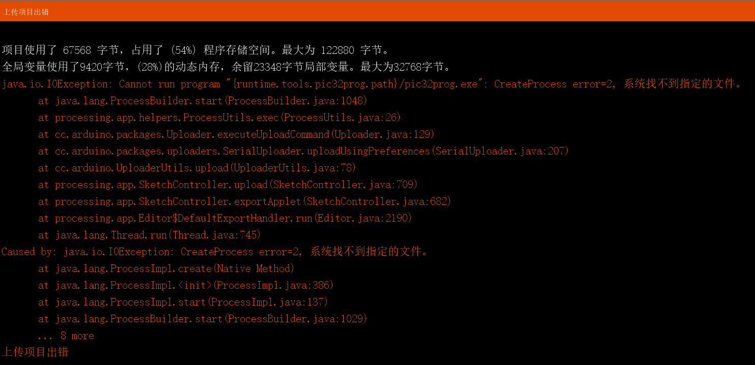

now, it can compile successfully, but it cannot upload DefaultBoard.ino successfully, some errors occured like this:
could you please give me some suggestions?
