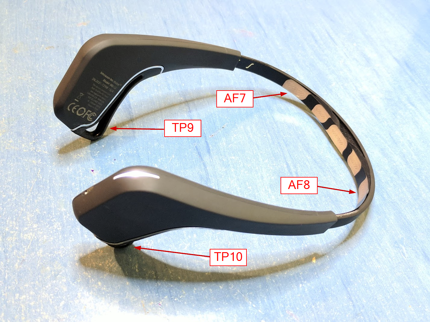

Another thought I had about your Muse / Myndlife 1 uV alpha @ Pz. All EEG is measured differentially. Meaning that the closer the reference electrode is to the site being measured, the lower will be the difference voltage.
Most typical neurofeedback is using the reference on the ear lobe. One or both, if linked.
Muse reference location is not completely clear to me. Is it at the forehead, or at the earpieces? (To better match traditional measured amplitudes?) Earpiece is touching basically at the upper rear portion of the ear, where the conductive rubber 'earpiece' touches the ear surface. This is considerably higher than the ear lobes. And actually over a portion of the cortex / temporal lobes. (Very close to T3, T4 sites.) Whereas ear lobes are mostly OFF the cortex.
I do know that with traditional neurofeedback, ear lobe references, that measured amplitudes at T3, T4 are MUCH lower than at other sites, for just this reason. With Muse and Pz, (if ear references) you're going to see the same type of effect.
A last observation is that Muse ear contacts are conductive rubber. In our tests at OpenBCI with various conductive rubber materials, these typically have a resistance much HIGHER than metallic or silver chloride type electrodes. Further reducing the differential voltage measured. All the other Muse electrodes are at the forehead and metallic.

Regarding the possible electrodes in Muse that can act as reference, apparently the three central electrodes on the forehead are all part of the 'default' reference system. Leaving these four locations,
So indeed, TP9 and TP10 are the rubber ear contacts. And the rubber is a long strip, with the main contact at the upper part of the ear. That's cool that the various Muse apps can choose the mathematically derived reference location. As long as users / developers can agree on what are the 'standard' reference locations across various applications. Especially those that attempt to replicate QEEG capabilities using 4 + (1 aux) channels.
