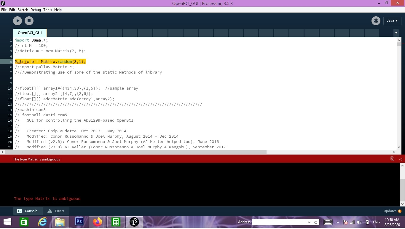

thank you, I could import Jama.* in processing. but I have a problem, when write this code :
Matrix b = Matrix.random(3,1);
processing has this error : The type Matrix is ambiguous
Please post your question on the jama email discussion list. 'Ambiguous' sounds like a Java type conflict.
