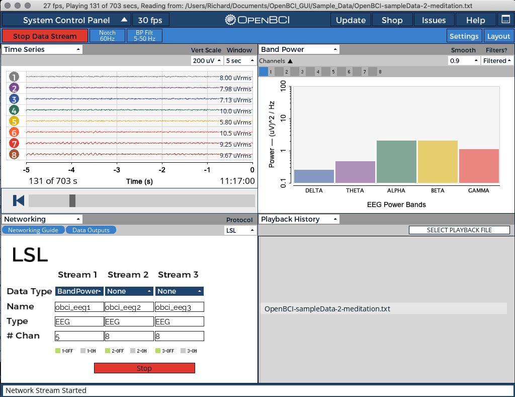

My device is Ultracortex Mark IV kit. I want to stream Band Power from LSL networking. What is the value in #channel that I have to set it?

    To answer your original question:
    • I tried both 8 (when using 8 channel synthetic mode)
    • and I tried 5 (number of power bands)
    • Got weird results both times using the Networking Test Kit that's in the GUI repository
    I am going to link to this thread on an existing issue to remove the confusing "# Chan" textbox.
    https://github.com/OpenBCI/OpenBCI_GUI/issues/644
    Again, thank you for noticing this, and I have upgraded the priority of this to high-priority for GUI v5.

    The answer is 5.
    Looking yet again at the output from the Networking Test Kit:
    [[0.594548761844635, 2.158696174621582, 2.4985361099243164, 2.541076183319092, 2.3395707607269287], [0.3957584798336029, 1.20045006275177, 1.5954006910324097, 2.426534652709961, 1.9610735177993774], [0.6398046612739563, 1.4542295932769775, 2.600311756134033, 2.315763473510742, 1.0340502262115479], [0.7538342475891113, 2.292661666870117, 5.157269477844238, 2.372204303741455, 1.2841973304748535], [0.1286601722240448, 0.3700842261314392, 2.6763808727264404, 1.8476436138153076, 1.1666150093078613], [0.31063926219940186, 0.9246240854263306, 3.560356378555298, 2.744607448577881, 1.5550593137741089], [0.2162628024816513, 0.865609347820282, 9.070088386535645, 3.5265231132507324, 1.7065619230270386], [0.3282938599586487, 0.7916330099105835, 8.12212085723877, 4.3278608322143555, 2.2962303161621094], [0.0, 0.0, 0.0, 0.0, 0.0], [0.0, 0.0, 0.0, 0.0, 0.0], [0.0, 0.0, 0.0, 0.0, 0.0], [0.0, 0.0, 0.0, 0.0, 0.0], [0.0, 0.0, 0.0, 0.0, 0.0], [0.0, 0.0, 0.0, 0.0, 0.0], [0.0, 0.0, 0.0, 0.0, 0.0], [0.0, 0.0, 0.0, 0.0, 0.0]]
    This is the output from:
    It sends out 5 band power values per channel, but for some reason tries to send out 16 channels worth of data even though we are using 8 channels in the example.
    Removing the line
    float[] avgPowerLSL = new float[numChan*numBandPower];
  • vannvann Cambodia
    I have set it to 5. Everything seems to work for my case. Thank you for your support.
