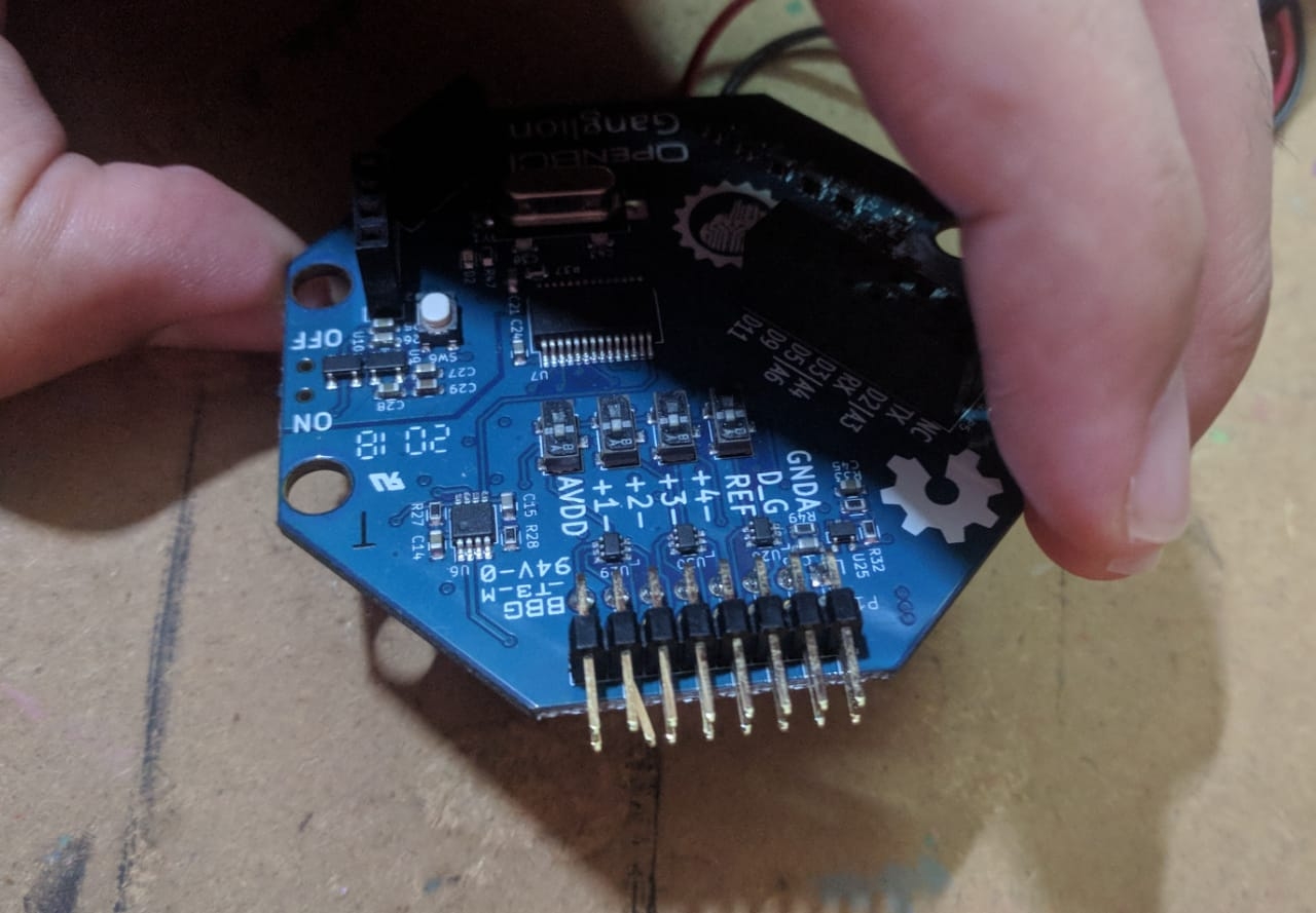

The problem we are facing is that on our ganglion board, the -ve pin for channel 1 came twisted (See attached picture) . So, it is not possible to use both +ve & -ve of all the channels.
Is it possible that we keep SW1, SW2,SW3 in down position (default for EEG) thereby only use +ve pins of channel 1,2,3 and SW4 in up position (for ecg) thereby use +ve & -ve pins of channel 4 ?
Also what will be the best ground electrode placement on hand for ECG ??
You should gently reposition that pin. This is very rare.
Hi Lakshay, ask your technician friends if they have what are called "needle nose pliers". This kind of tool can easily grab and gently bend the pin back to normal position.
