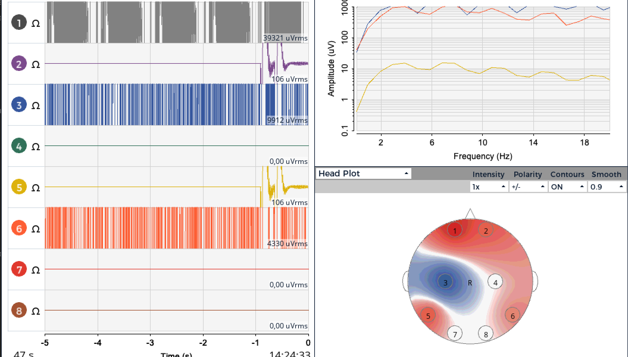

I'v got the cyton board with daisy module 3 years ago and it all worked fine. Now I have the following problem after not using it for couple of months:
In the OpenBCI GUI (4.2.0) I get extremely high voltages when running without daisy module (~ 50'000 uV). And channel 1 seems to have a unusual repeating pattern.
With the daisy module I get no signal at all.

    1. Please provide screenshots for this type of issue. This will help resolve the matter quicker.
    2. Also, please provide a console log file, after you attempt to connect to the board. You can find the console log in the top right of the GUI.
