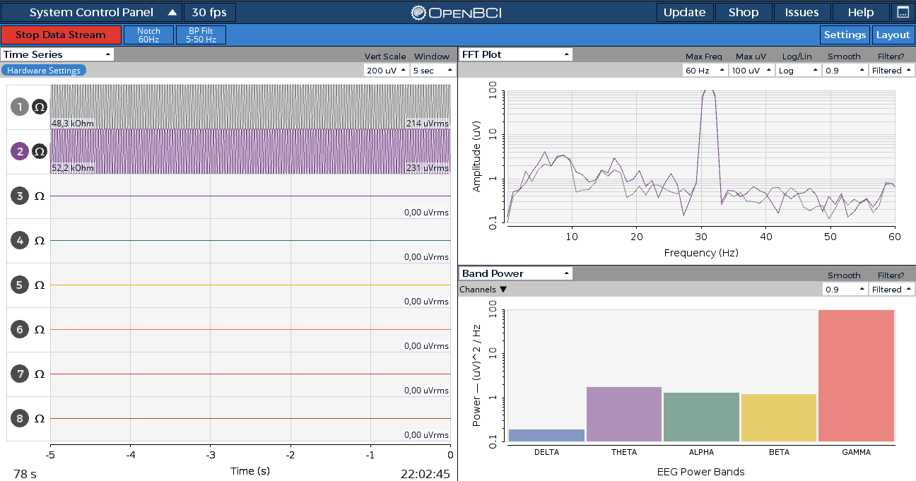

    I did three tests, the first using my Ultracortex Mark III printed by myself, below is a screenshot where I'm measuring the impedance to the electrodes 7 and 8:

    Looking the readme of the OpenBCI_NodeJS_Cyton github repository, I know that a Good value is < 5k Ohms, which is not the case for any of my tests.
    If anyone can help me, thank you very much!
    edited April 2020
    Mauricio, hi.
    5K ohm impedance is only possible with wet electrodes (gel or paste). And generally some type of skin prep is usually required to get as low as possible. Such as removing skin oils or skin abrasion with NuPrep.
    The 5K impedance figure was a relic of the older amplifiers which had low input impedance (in the megohms range). Cyton (ADS1299) has very HIGH impedance inputs (1 gigaohm at the front end), which means higher skin-electrode impedances are acceptable for both dry and electrolyte contacts.
    https://openbci.com/forum/index.php?p=/discussion/2517/expected-impedance-range-with-ultracortex-cyton-resolved
    https://openbci.com/forum/index.php?p=/discussion/2206/what-is-the-relationship-between-high-impedance-on-eeg-channels-and-50-60hz-noise
  • retiututretiutut Louisiana, USA
    There will be "noise" when impedance check is active. The only thing that is meaningful is the XXX kOhm reading on the left of each ChannelBar in TimeSeries.
    Richard, thanks. I was spacing out the 31 Hz generated frequency used to find the impedance. Yes, this is actually normal. Though I seem to recall really older GUI's did not show it so prominently. Maybe because of the way the scale factors were set.
  • So, the impedances in the test with my Ultracortex Mark III (which is what I want to use) are acceptable.
    Thanks for the quick answers!
