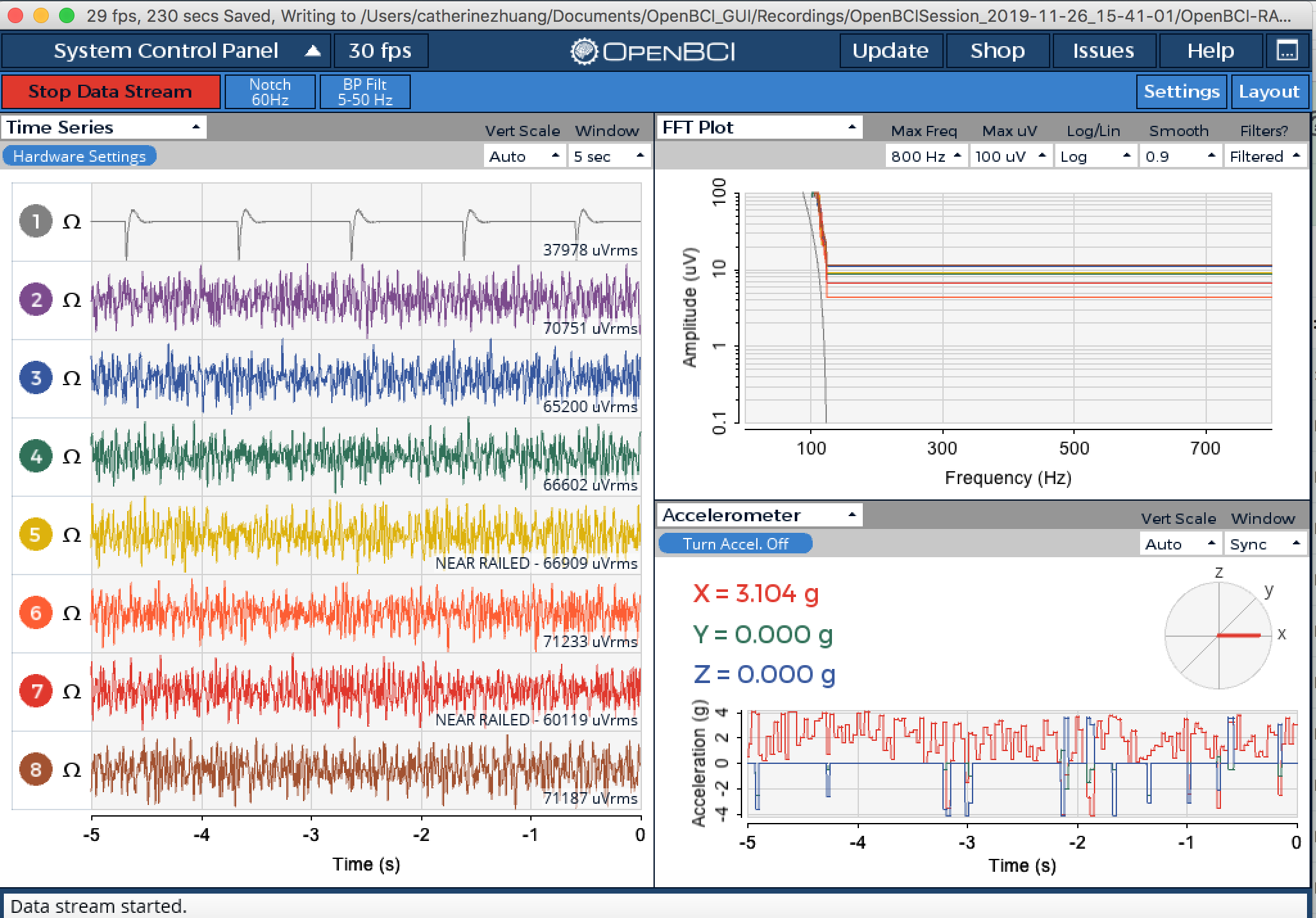

I updated the firmware of the cyton board to the latest version recently to work with the latest OpenBCI GUI. However, after the update, there seems to be no communication between the board and the dongle. There are both blue lights on the dongle and the cyton board when they are powered on and when I start to stream data, the red light also shows up on the dongle but the time series plot looks at this.

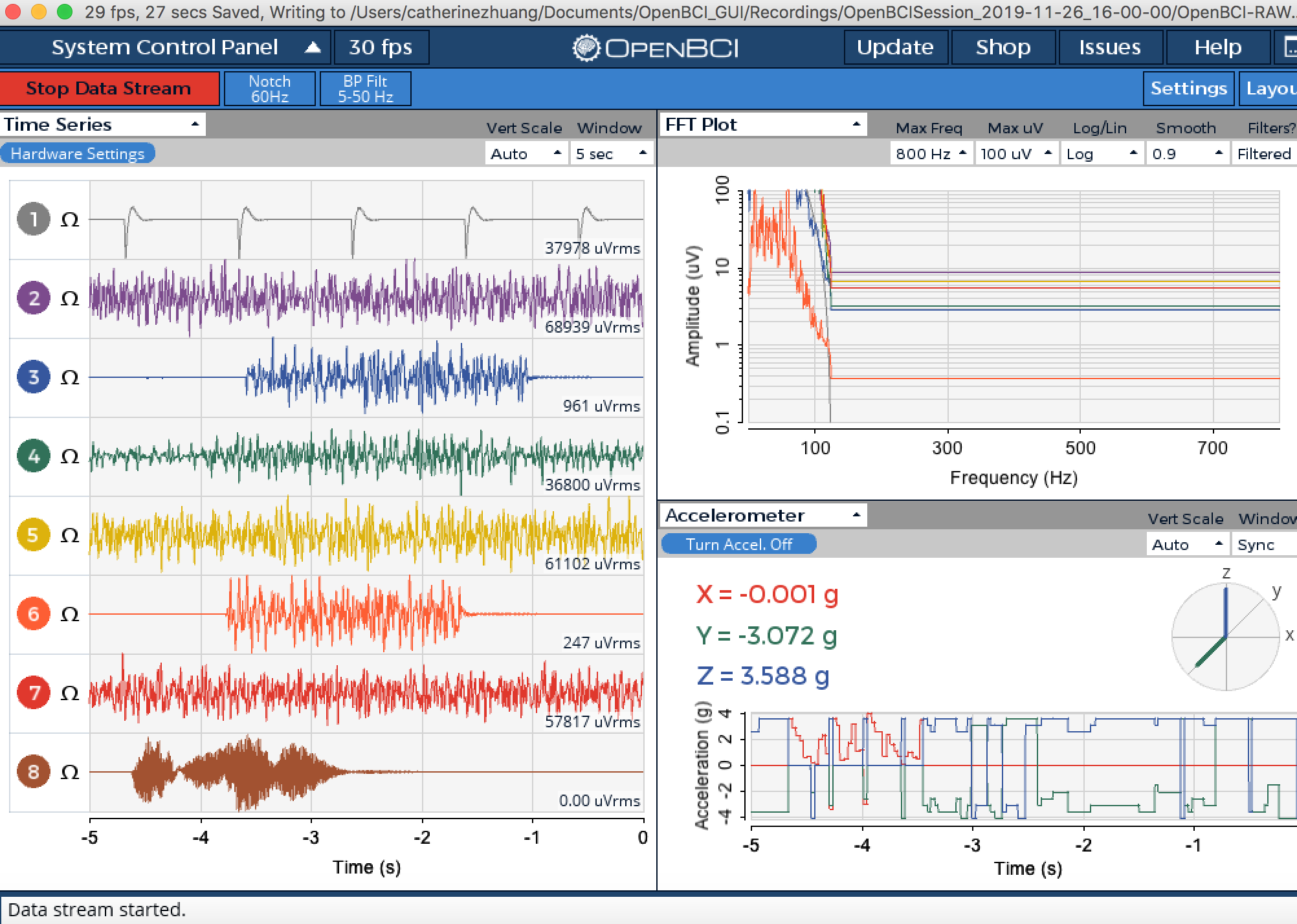

I tried to touch the pins with my fingers to test the connection as the docs said but all channels still show noise and nothing in particular had changed. I also tried connecting the gold cup electrodes to the board and got similar plots (nearly railed and noise on most of the channels) and there no major difference when I touch the goldcups either.
One weird thing that I noticed is that I put my board flat on the table but the accelerator still shows movements for some reason.
I am using OpenBCI GUI version 4.1.6 and Cyton firmware v3.1.2.
