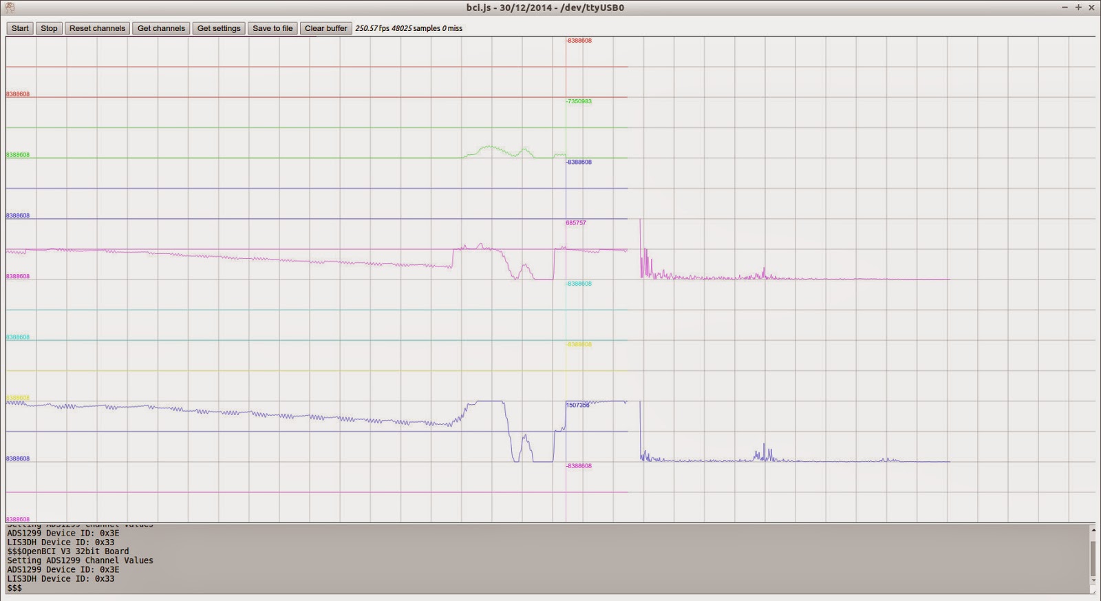

  • Yes of course, it was my intention. I'll make my code roughly presentable and do that asap. (At this time it's more a feasibility study, and I did found not a way to stream data to file. Even with the chrome filesystem api, user seems to have to make an action. The only solution I see is to make a simple node.js server, to store to file or database.)
  • Please find my first draft here : https://github.com/Gwym/bci.js

    Yes I pushed a basis for the node.js version some times ago, I am currently on merging the webapp and the chromeapp to avoid duplicate « client side » code. I wanted to change from current time-based protocol to a parser based one that would allow to decode board state, but I am facing a problem : I got a lot of errors that do not allow the parser to work well, and I currently don't know if these are coming from board, from drivers or from elsewhere.
    For example, I sometimes got in my logs (directly from node-serial output) :
    « updating iWedance detect setings »
    instead of
    « updating impedance detect setings »
    or
    « CH6SET, 0x0A, 0x69, 0, 1, 1, 0, 1, 0, 0, 1
    , 0x0B, 0x69, 0, 1, 1, 0, 1, 0, 0, 1
    CH8SET, 0x0C, 0x69, 0, 1, 1, 0, 1, 0, 0, 1 »
    instead of
    « CH6SET, 0x0A, 0xE0, 1, 1, 1, 0, 0, 0, 0, 0
    CH7SET, 0x0B, 0x68, 0, 1, 1, 0, 1, 0, 0, 0
    CH8SET, 0x0C, 0x68, 0, 1, 1, 0, 1, 0, 0, 0 »
    and so on, so i am investigating further for now.
