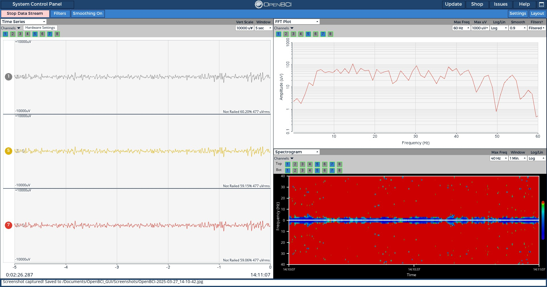

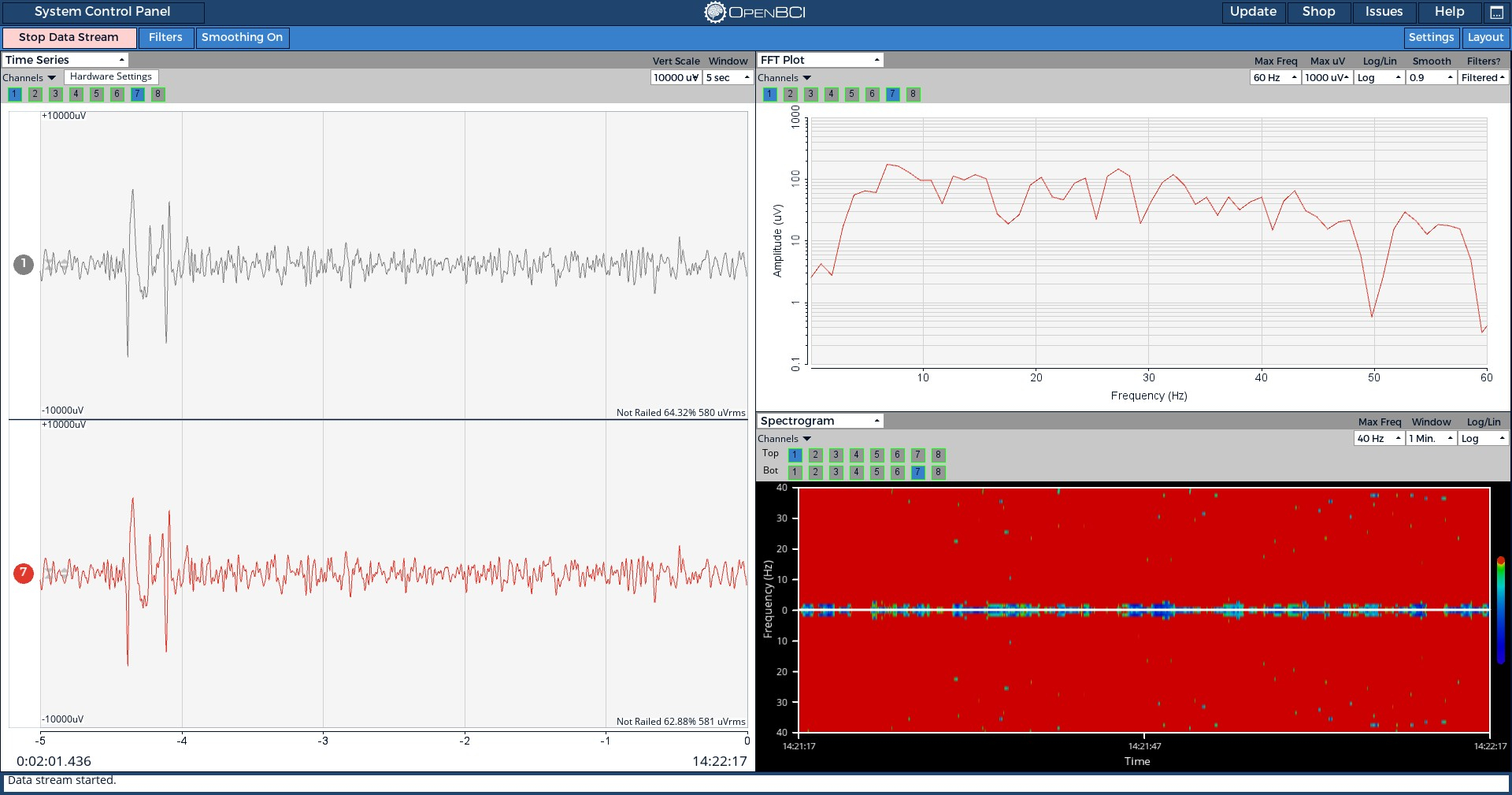

Okay, I made a test with gold cup electrodes and 10-20 paste, after applying skin prep gel. The signal couldn't be more similar.
1 - Fp1, 5 - FPz, 7 - Fp2, SRB & Bias the ear lobes
1 - Fp1, Bias board pin - FPz, 7 - Fp2, SRB on the ear lobe
1 - Fp1, Bias board pin - FPz, 7 - Fp2, SRB between FPz and the Nasion, and in another room
Btw, I had made tests with the EEG minisim, and the signals seemed ok, even in the 10 uV. Other than that, for as long as I can remember (since around Sep - Oct), I am trying to validate the recorded signal. Could there be an issue on the board reference? It would be somehow consistent with trying different electrodes/locations on the head and since the minisim produces the same signal in all of its outputs. Or am I missing anything else?
