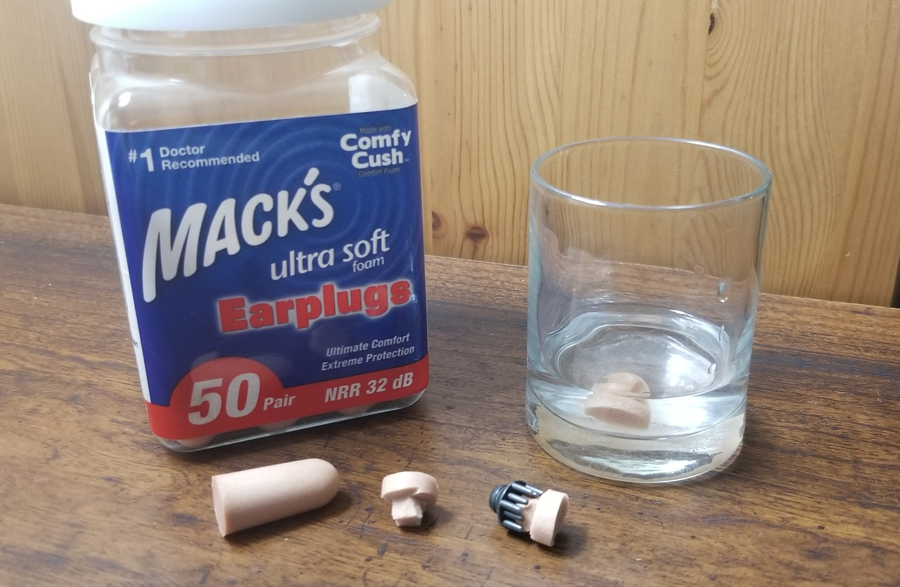

    I had seen a very old post on a blog where someone had made their own sensors using foam earplugs and RCA cable connectors. I had some of the same type earplugs and I trimmed them up to fit into the comb electrodes. These work very well too, another variation on same theme.
