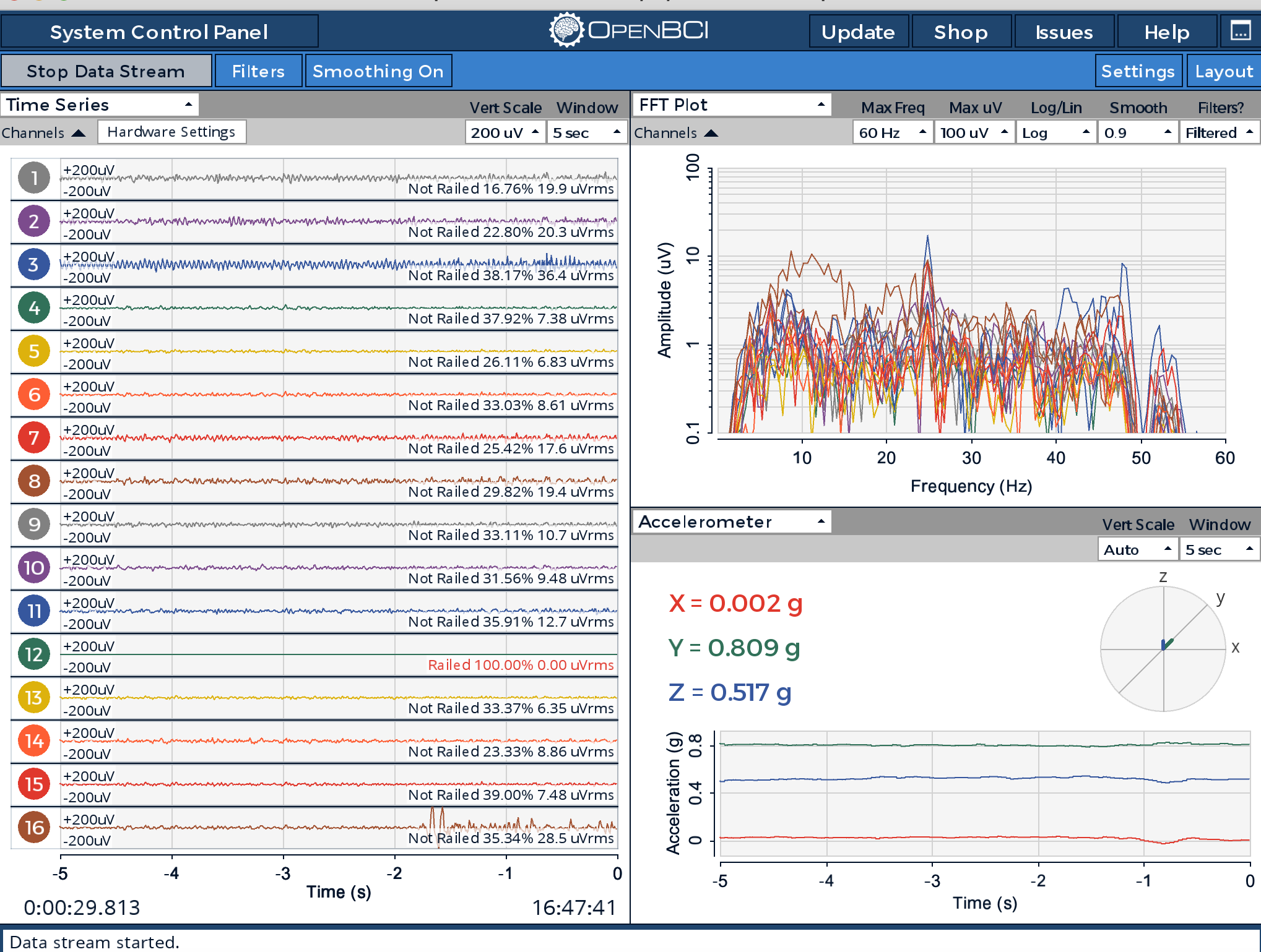

I changed that 12 channel electrodes and it can work now. Many thanks! By the way, the software always warn that there are some packet loss when data streaming. Is there any way which can avoid packet loss?

It sounds likely you have some issue with your channel 12 wires or electrode. You can verify this by temporarily swapping with another channel.
