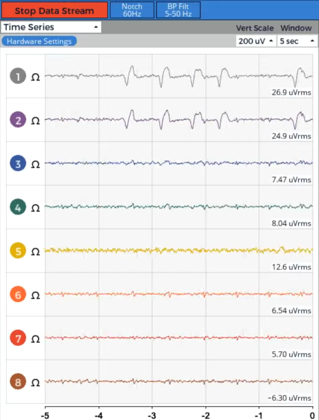

I'm using the Cyton board to detect the EEG signal. In my experiments, I found sometimes a negative uVrms value would come up from some channels. Usually, it happens on channel 8. This negative uVrms value always close to 0 and within -20uVrms. I'm not sure if this negative value is normal behavier and if it's corret. Did you guys encounter this phenomenon? How do you deal with it?

    Not sure how this would be possible with 5.0.1. Here is the code used to get Root Mean Square:
    //compute the standard deviation
    float std(float[] data) {
        //calc mean
        float ave = mean(data);
        //calc sum of squares relative to mean
        float val = 0;
        for (int i=0; i < data.length; i++) {
            val += pow(data[i]-ave,2);
        // divide by n to make it the average
        val /= data.length;
        //take square-root and return the standard
        return (float)Math.sqrt(val);
    https://mathworld.wolfram.com/Root-Mean-Square.html
