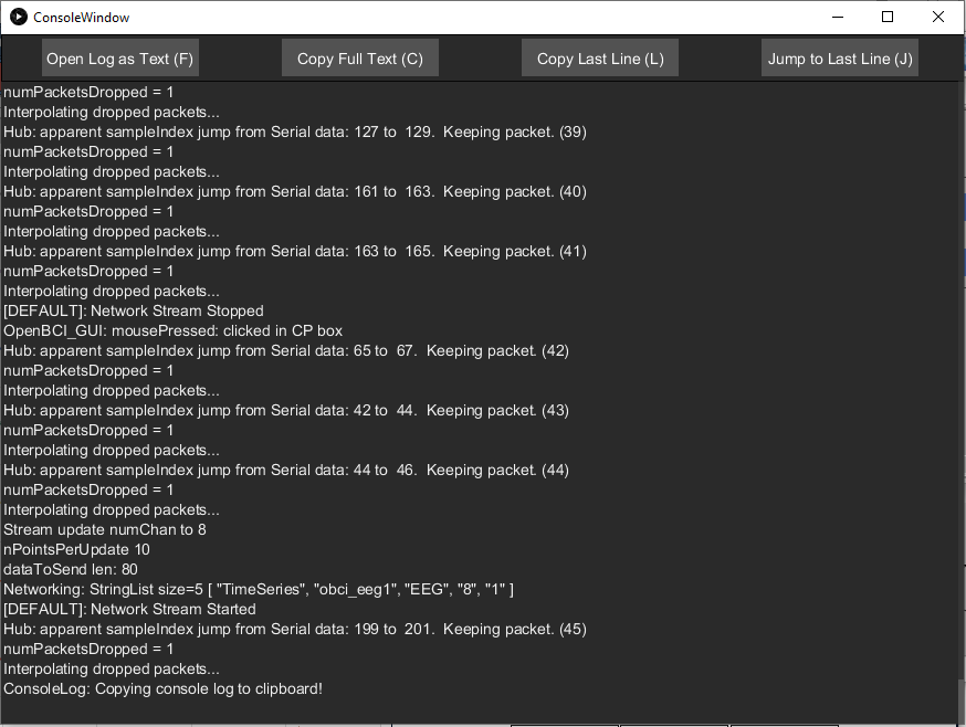

1. Start GUI start, cyton autoconnect, open console
2. Configure and then start one LSL stream of the Timeseries of type EEG for all 8 channels

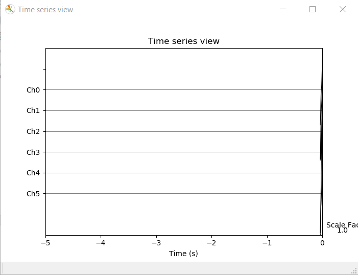

4. Starting Neuropype Pipeline designer (changing example program to receive my EEG stream)
5. For some reason only some fluctuation visible around t=0, see below
6. Program receives Data as seen below

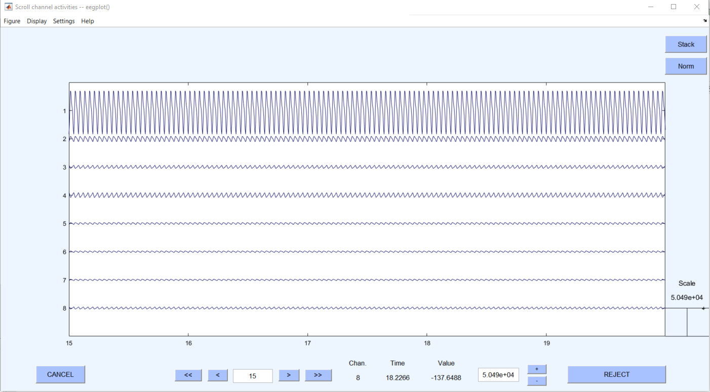

12. EEGLAB: Inspect/reject data per eye, this does not look like EEG!
13. To make sure it not just because the data is unfiltered, I applied a Bandpass filter from 2 to 49 Hz
14. Barely any change throughout the data, As Neuropype, LSL, Lab recorder and EEGLAB are all programmed by the same people could the problem be the GUI?

18. exit experiment and starting restart... GUI freezes after execution, nothing unusual in console (I could also provide the entire console output)

2. Data streamed with GUI over LSL (and recorded (lab Recorder) or used online (Neuropype)) is corrupted
@retiutut I know that you implemented LSL into the GUI. Do you have any idea what the source of the above described problems could be? Also, what data is exactly transmitted over LSL? - do the filters applied in the GUI change the data or is always the raw data transmitted? Where could be the reason for the data being so analog repetitive despite that is not what has been recorded. I am not very experienced with EEG and the software used but I tried to do it as careful as possible. I would really appreciate any support!

    I did not implement LSL, I only came in and tried to repair it from being completely broken. The data is not corrupted, there is a possible issue with sample rate and LSL. Right now the priority is to work on GUI v5, which does not contain the Hub. LSL is now tested using simple Python scripts. I'm not sure I can provide any more support here, as the post is too complicated. I will have to get approval to look into this further.
